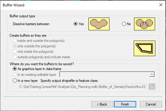

Please bring the Buffer Wizard functionality into ArcGIS Pro. I like having the ability to  save the buffer in an existing editable layer rather than creating a new buffer feature class each time I need to buffer a new feature.

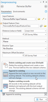

Hi @SarahHartholt, I wanted to add another possible solution to this, have you checked out the Overwrite Options available for geoprocessing tools in Pro 3.5? The Append To Existing option can be used to add new buffer outputs to an existing dataset, rather than deleting and creating a new output each time. You will get the Overwrite Options menu if you specify the Output Feature Class with an existing dataset.
MargaretCrawford
Although, the only difference I notice between your request and the Overwrite Options, is that when using the Append To Existing option, you can only add your outputs to a saved dataset, not to an existing layer.  Let me know if this solution meets your requirements, or if there are specific aspects you'd like to explore further?
