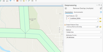

This is not offered as part of Buffer, but for the last several releases of ArcGIS Pro we have had the tool Remove Overlaps (multiple) in the Analysis Tools toolbox, that can be used for the described purpose. I wrote the intermediate buffers into memory, then removed their overlap using the Centerline option to split the overlapping buffer shapes with output to a final output feature class.
