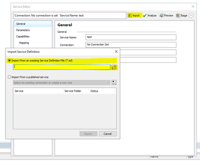

Include functionality that currently exists in ArcMap to import an existing Service Definition (.sd) file.
Importing a SD file allows users to re-publish an existing service and pull in the existing properties of that service (including all of the parameters and descriptions).
Currently, overwriting the service requires re-inputting the parameters and descriptions.
This ArcGIS Idea is related, and could potentially provide a workflow, but only if there is functionality to import the existing details of a service during the overwrite process:
https://community.esri.com/t5/arcgis-pro-ideas/add-quot-save-as-sd-quot-to-overwrite-an-existing/idi...
Existing ArcMap examples:

Hey @JonahLay , unfortunately no.  Doesn't look like there is even an import option with that tool - just a way to publish a service from an .SD file.
We create .sd files to upload/publish on each of our servers*.  When changes are needed (such as symbology updates, definition query updates, or adding/removing data layers), we will re-author the existing service (usually a saved mxd or map file), and import the existing .sd file to copy over all of the parameters and descriptions.
This tool could work for the upload process itself, but wouldn't help in transferring the parameters/descriptions from an existing service to a new one.
