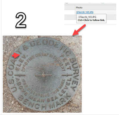

@SSWoodward thanks for keeping an eye on this much needed and as @MikeJensen said long overdue functionality.  Coming from the field / mobile side of GIS, every one of the "big three", QC/Survey123/FM all have, as they should, an integration with a mobile device camera but moving photos out from the GDB construct to other photo handling mechanisms are key.   Here for example is a leading Survey grade processing software, Trimble Business Center capacity.  Once a feature is assigned an attribute called a "photo attribute", a single photo path is written to the text field.  Access now is made available to a folder generated during an export (say a GDB or Shapefile) to a folder that a user may not have access to the program, after a user selects "yes" to Copy related files.
The result, simple, accessible access to photos in this case populated with a .\Files\path.   Sometimes, the simple path is the best path, and not all and everyone desires data in the current storage mechanisms in place now.
