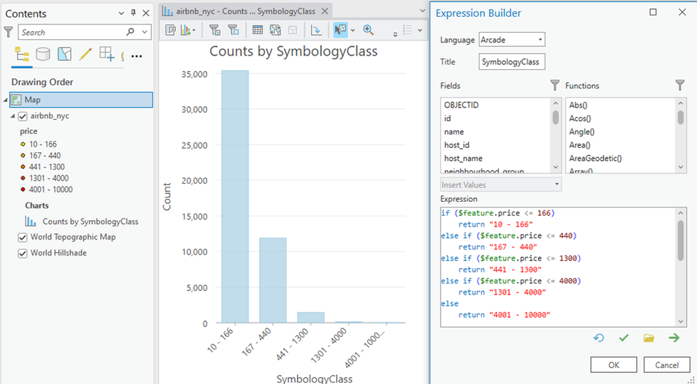

In the 3.1 release of Pro, it will be possible to configure bar charts using Arcade expressions. This should allow you to create a bar chart that displays graduated color symbology classes without needing to update the attribute table with a new field:
However, as you can see in the screenshot, this solution will not allow you to match colors. We will consider a more convenient method for visualizing symbology classes (including color matching) with a bar chart.
