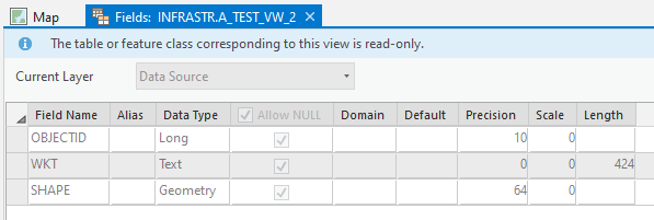

I've created a database view in my EGDB using an SQL Client:

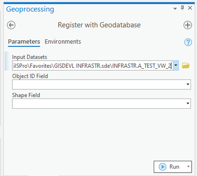

I want to register the view with the geodatabase:
I noticed that the Object ID Field and the Shape Field parameters haven't been auto-populated, despite the view using standard names for those fields: OBJECTID and SHAPE.
Could the Register with Geodatabase tool be enhanced so that those fields get auto-populated if OBJECTID and SHAPE fields are present in the data?
