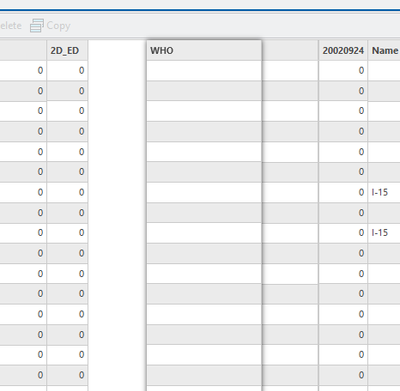

When reordering fields in the Attribute Table, the column is "animated" like this:

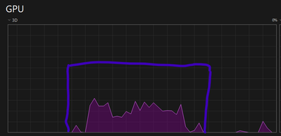

This is nice, if you only have a few columns, but once you need to move to the side, this animation will cause significant GPU load and the animation will no longer look smooth at this speed.
(To reproduce it, create 500 fields, then move a field from the first to the last position)

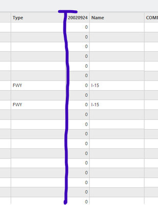

I´d suggest to use an insert marker like this:

Also keep the field that is being moved visible while it is being dragged (fields currently vanish when you move them to far to the left and partially visible when you move them to the right)
