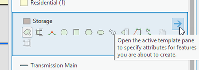

And just an FYI regarding feature templates: you mention setting up default values for templates can be cumbersome with a lot of templates, which is true, but did you ever try using the Active Template pane for setting temporary default attributes while creating new features:

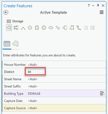

For example, this value of '88' will be remembered as long as this template remains active:

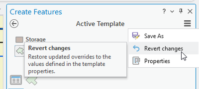

You can also revert to the default values or save the attributes to a new feature template, if needed:
