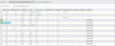

wayfaringrob
@JonathanMurphyI see. I'm not exactly sure why I wasn't seeing it before but it is appearing now. It would be great if each individual view asked you as it's not clear when the box comes up what, exactly, it's asking to save changes to then. Further, I just closed a fields view (with pending changes) before closing a domains view (changes already saved); upon closing the domains view, the box did come up, but I'm stuck in a loop with it - clicking "yes" doesn't do anything, the box just comes back up.

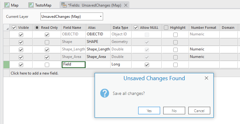

KoryKramer
I see a dialog every time I try to close a view with unsaved changes...
