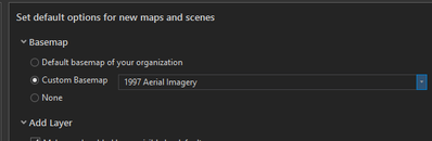

You can tell Pro you'd like a different default basemap in new maps and scenes in Options → Application → Map and Scene.
This requires the selected map to be in the org's basemap gallery, but that's as simple as sharing a map from Pro to your basemaps group.

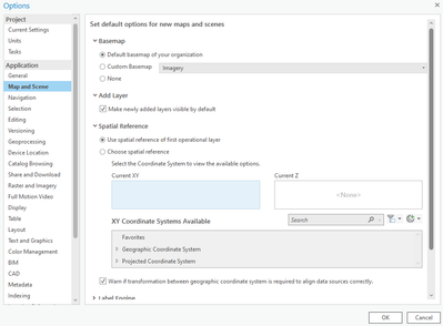

In Pro at this same location
you can set a default spatial reference that will over ride the 'use spatial reference of first operational layer' default.

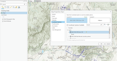

Since ArcGIS Pro's map frames take the projection/coordinate system of the first layer added to the map (basemap) the rest of the data added later is re-projected on the fly.
This shouldn't be the case.  Looking at the help for Map and scene options https://pro.arcgis.com/en/pro-app/latest/help/mapping/properties/default-settings-for-new-maps-and-s... It should be the first layer added that is not a basemap will set the map's spatial reference:
In this example, I added a new Map to my project and it's spatial reference was WGS 84 Web Mercator Auxiliary Sphere.  Once I added an operational layer (Roads) I see that my map's spatial reference is now NAD 1983 UTM Zone 12N:
There is another option to 'Choose spatial reference' so you could set that but if all of your data is in UTM 15N then maps's spatial reference should be set to that when operational layers are added.
