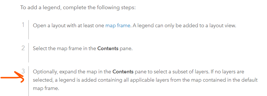

@DeonzaMohamed Can I ask why you are adding the legend with multiple layers and then unchecking all of them? Are you unchecking all of them, and then checking back on just 1 or 2?
If you just want specific map layers as part of the legend when you insert it, you can select only those layers in the Contents pane, and those are all that will be added when you insert the legend: https://pro.arcgis.com/en/pro-app/latest/help/layouts/add-a-legend.htm
Or, if you still need a way to insert all the layers and turn all of them off at the same time, I'd recommend using the keyboard shortcuts Ctrl + click (to turn all layers off) or Alt + click (to keep that one layer visible and turn other layers off.)
