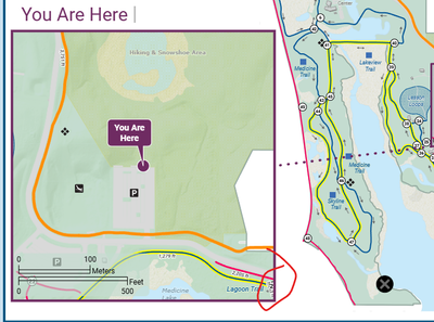

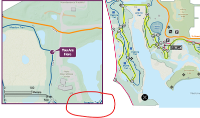

We've recently discovered a limitation in labeling that we believe would be a beneficial addition. There currenly is not a setting for map labels to be aware of Map Frame's layout boundary, therefore they get clipped/truncated.
We would like for there to be a setting to 'label within map frame boundary', and that the labels respect this boundary and either label within it, or don't get labeled at all.
Here are a few examples of the issue-
Thank you for this consideration,
Amanda Huber

Labeling respect the map frame edge in all cases except when it's told not to. Settings that tell it not to  include:
  • Label class level property: Never remove (place overlapping)
  • The map level property: Allow labels to overlap border
There is zero buffer applied to the boundary, so labels may be right against it if they fit. It's a bit hard to tell in your images, but some examples may be that. As for the overlap case, it's hard to determine what is going on there, but perhaps Never remove is enabled.
