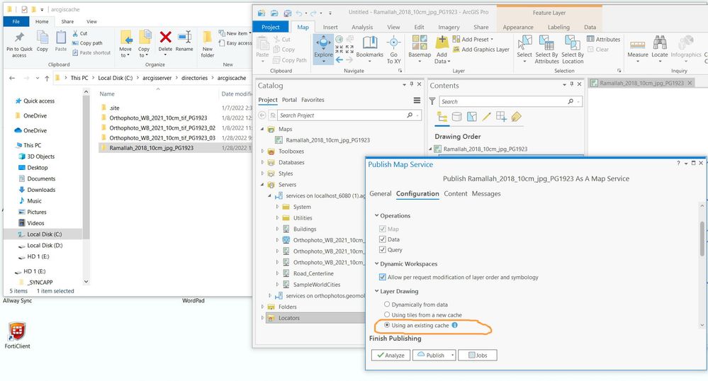

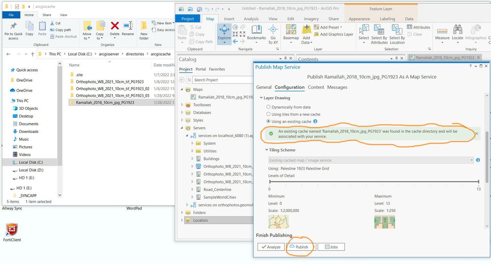

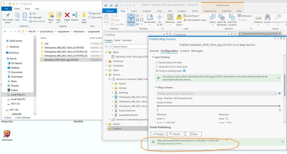

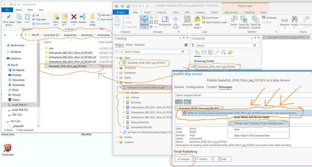

JamalNUMAN
With Pro 2.9.1 and ArcGIS Server 10.9.1, publishing a service map with same name as a cached service gets it detected!
