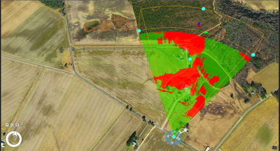

We have found this tool to be interesting except for 2 limitations:
  1. You cannot export the VS to a Raster or Vector Feature; Only to a point FC which is not useful
  2. When placing an interactive point and then moving it, the tool does not honor the offset altitude for the viewpoint. For example if I place a VS on a hill and give it a 100 Foot offset and then move the point down off the hill, it remains at the same elevation which results in unrealistic results. Can there be an option to dynamically update the VS offset when the original point is moved? This is crucial in judging the best locations for viewsheds.
Original Location with 100 Foot Offset on Hill
Original Location
Second location with VS moved down hill. Notice the offset is significantly more than 100 Feet now.
2nd Location

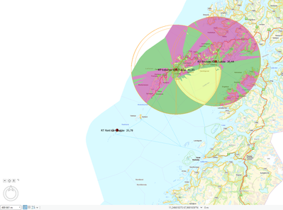

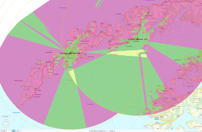

EvenStangebye
When using the Viewshed tool under Exploratory 3D Analysis, the result changes when viewed in different scales. Under the result viewed in scale 1:155000
..and here the result viewed in 1:490000
The result as cleary different.
There should be a button/choice whether to use the full DTM/Analyse in all scales (longer processing time) to make sure the result is the same in all scales, or to use a simplified solution when zooming out - as it is today. As it is now I can not use the visual result of the analysis as it changes due to scale.
I also support the export of the result (not only the center point of the analysis) either as polygons, raster, tin og 3D Multipatch..
