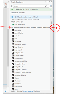

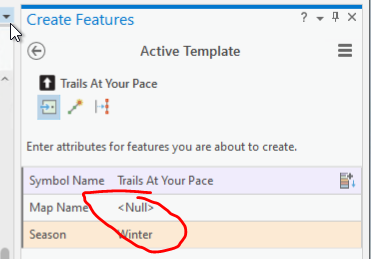

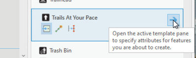

We would like to be able to manage attributes at the Layer level and not just the symbol level (please note I'm not quite sure what the formal terms are for these so bear with me).
Currently we can click the arrow at the symbol level for each symbol and assign the attributes for bulk creating:
We would like the ability to do this at the layer level for all symbols that fall under that layer:
Since all the attributes are the same in the dataset, with this workflow we could easily assign the attributes at the layer level and quickly create any features within that layer. This would immensely improve and speed up our workflow.

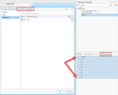

Can you please let us know if changing template properties in bulk will work for you?
  1. In Manage Templates, activate the layer in the top of the pane
  2. In the bottom of the pane, click on the first template and hold SHIFT key. While holding SHIFT click on the last template. All templates in the layer are selected.
  3. Click Properties. You can now update the attributes of multiple templates at once.

Changing template properties in bulk is available within the Manage Templates pane where you can select multiple templates by..
  • Hold CTRL+click on the specific templates you want
  • To select a specific group or templates: Click on one then while holding SHIFT click on the last one in a group
  • Or use CTRL+A to select all of the templates in the list
Now click on 'Properties' and the 'Multiple Templates' properties dialog opens where you can change defaults for all of the selected templates at once.
