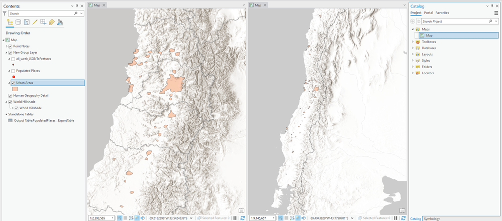

Just a note that when I originally asked for clarification from the OP he said he did not want to duplicate the map, just the view. Subsequent comments indicate that users are looking for the ability to actually duplicate the source map, with that action taking place from the view tab. These are two different things. From your description of "then I would change some of the layers, symbology, etc." I'm assuming that you want that to be in a different map. Is that true?
For example, if I duplicate the view (which continues to reference the same source map), here is what I get:
I can do things to the second view like change the scale, orientation and so on:

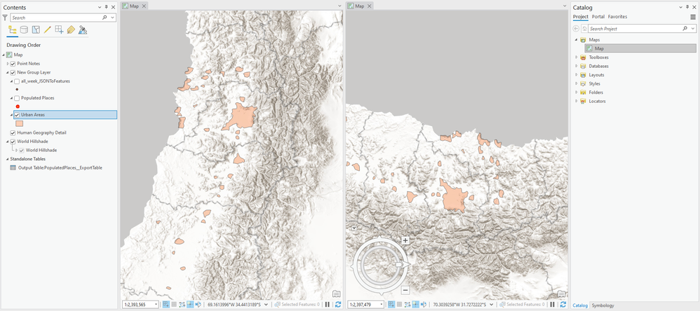

And when I turn another layer on, change symbology... that happens in both views because they are both pointed at the same map:
So are you interested in just duplicating the view tab (maintaining the reference to the same source map), or is your expectation that you duplicate the view tab but have the duplicated tab reference a duplicate of the original map? If the former, the current option is to simply open the same map again. If the latter, you would duplicate the map in the project first, and then open the duplicate map in its own view. Hope this helps, and please provide any further details on your expectations.
