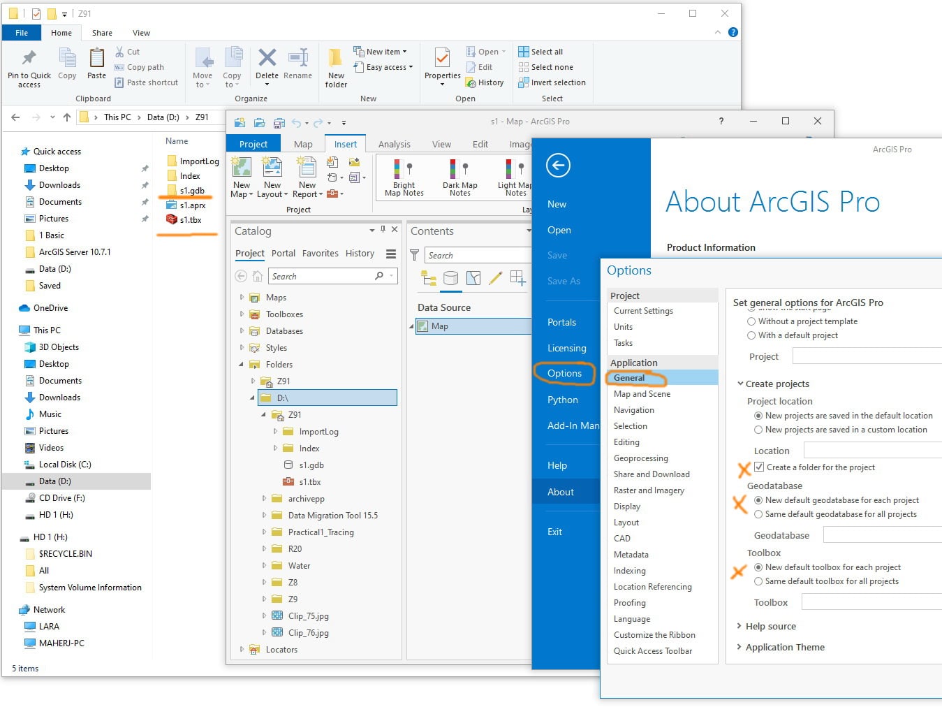

One side point, in case some people are not aware of this option when creating new projects: instead of letting ArcGIS Pro create a default geodatabase and toolbox, you can designate a pre-existing geodatabase and toolbox for all new projects that you create from here on, by using the settings in the Options dialog (General tab, Create projects section). Note that you can change these settings any time and as often as needed.

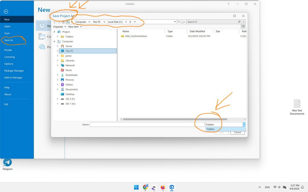

I observed that the "Save As" tool has two scenarios:
  • If the project has not already been saved, then the .aprx file will be compulsorily stored into a folder.
  • If the project has already been saved, then the .aprx is saved as a standalone .aprx file without the need to create a folder (similar to the experience with .mxd files).

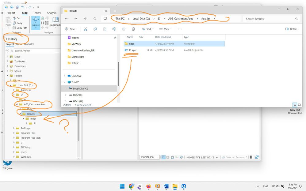

We need to have the option to save the .aprx as a standalone file without the need to have folder, toolbox, or gdb created!
Despite these steps, the .aprx is not displayed in the catalog (this issue has already been reported, and an idea has been created).
