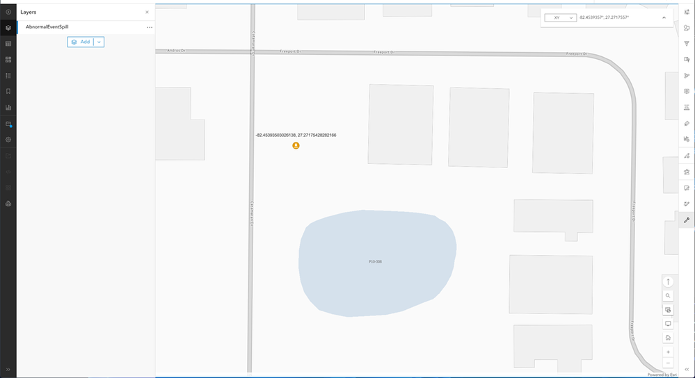

Yup, so there you go.  If the webmap basemap is using an ArcGIS Online web mercator basemap like the World Topo you will not get proper results because, like  posted above, the outstanding work by  @MDB_GIS does not - nor should it have to - account for a geographic transformation.
For NAD 1983 HARN StatePlane Florida West FIPS 0902 (US Feet) I use the NAD_1983_HARN_To_WGS_1984_2 transformation in the Pro desktop software.
Below, I have a StatePlane Florida West vector tile layer that I have used as the webmaps basemap, and you can see that the coordinate expression is a pretty good match:

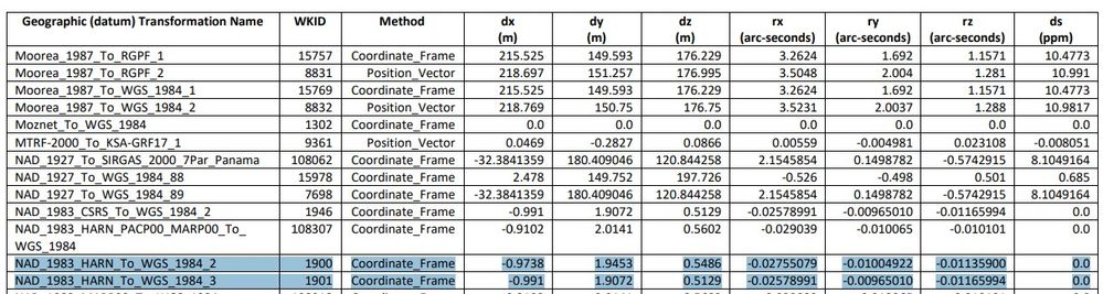

@DavidColey, just a minor point. I was going by the WKT of 2868. 2882 appears to use the same geographic transformation:
TOWGS84[-0.991,1.9072,0.5129,-1.25033E-07,-4.6785E-08,-5.6529E-08,0]
This appears to correspond better to NAD_1983_HARN_To_WGS_1984_3 than NAD_1983_HARN_To_WGS_1984_2
From ArcGIS Pro 3.6 Geographic and Vertical Transformation Tables :
The difference in the shown rotations are due to fact that the WKT definitions are in radians and the table shows arc seconds.
In practice, the difference is likely only a couple inches based on my eyeballing the parameters.
