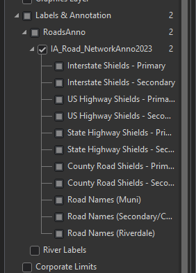

@AmeliaBradshaw  are you sure? When I Alt+Click the box for my Open Space layer, I still have other layers remaining selectable, and I can't batch uncheck the group.
Same with annotation layers -- they stayed selectable.

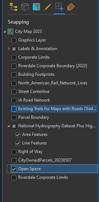

likewise on the snappability view

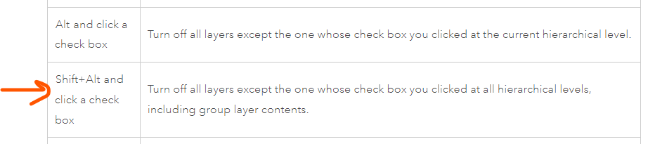

When working with grouped layers, it looks like this is what was added:
Miralem_Zeljo
Thank you Kory!
