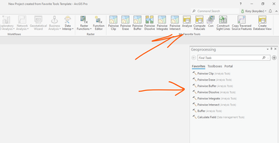

@DanPatterson beat me to it 😀  but I was also going to suggest some of the options outlined in https://pro.arcgis.com/en/pro-app/latest/help/analysis/geoprocessing/basics/customize-arcgis-pro-wit...
To carry across projects, you could add to the ribbon, or add to the GP Favorites, create a project template and create new projects from the template.

This is implemented in ArcGIS Pro 2.9.  See Ideas in ArcGIS Pro 2.9 and go directly to 1:23 in the video for a little demo.
