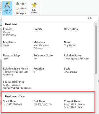

AubriOtis
Date fields and number fields are a little different, which is why those statistics don't currently work. However, we have time dynamic text options that might work for you. Will these provide what you need or are there additional elements missing?

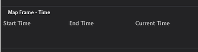

ChelseaRozek
Hi @AubriOtis , I'm hoping the offerings can be improved upon. That screenshot does not help me because it's the map frame's start/end times and not the values from my point feature class. I'm not working with the layer time enabled so there are no values for me (see below).
