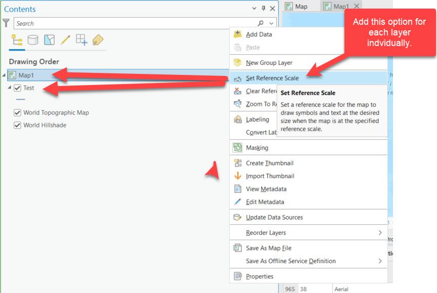

Kory,  This is awesome info but, we are talking about 2 different things. Display filters and reference scale display.
We have some layers where we want to keep sized to certain display scale and not increase in size as we zoom in and out. The idea is to allow users to set reference scale for each layer independently vs only having ability to do it from the map propoerties:
