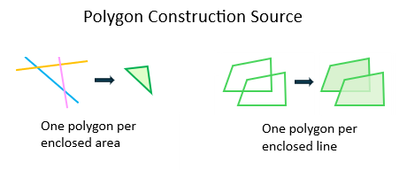

Here is a simple illustration of the new parameter in Feature To Polygon tool. On the left below is the default option, which is how the tool has worked for decades. On the right is the new option which makes a polygon from each individual enclosed line regardless of their crossing each other; the output polygon will carry all input line attributes. Hope this will help shorten your workflows.  🙂
