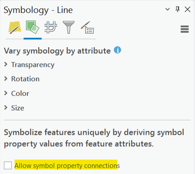

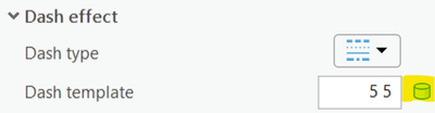

You can configure the dash pattern if you Allow symbol property connections
Then in the symbology for the line feature you can configure the Dash template to reference a field or an Arcade expression.

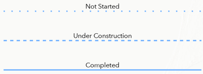

Use a custom Arcade expression to specify the dash pattern for different attribute values. Here's a sample script using your example. Note that the solid line uses a dash pattern with a dash width of zero.
Decode($feature.Construction_Type,
  "Not Started", "2 10", //dotted pattern
  "Under Construction", "5 5", //dashed pattern
  "1 0" //default to solid pattern (Construction completed)
And here's what that looks like on the map:
