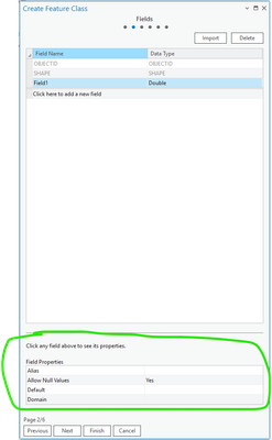

To the best of my knowledge, having the ability to define precision and scale, specifically on the Create New Feature Class/Table interface has NEVER been available in Pro.
This IS available in ArcMap/Catalog, and as many commentors have mentioned, having this ability seems rather simple given that it's available in ArcMap/Catalog and for certain Pro tools (ex: Add Field tool), and its omission is frustrating, especially going on 10 years of having Pro.
Pro Create New Feature Class Interface --- this is an enterprise geodatabase --- no ability to define precision and scale in the field properties

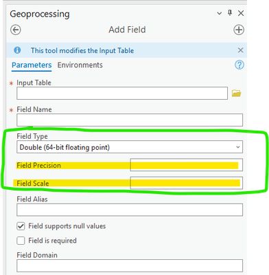

Pro Add Field tool --- Precision and Scale ARE available
