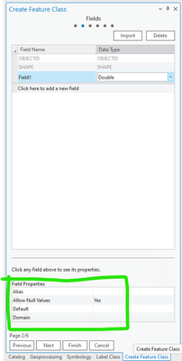

I'd like the precision and scale to be options when creating a new feature class by right-clicking on a database connection and selecting New | Feature Class.  Circled in green is the area where I'd like to see the precision and scale be options.  If you create a text field through this interface you can define the max characters...something similar for double fields would be nice, in my opinion.

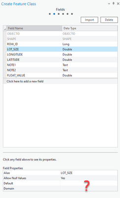

ZachBodenner

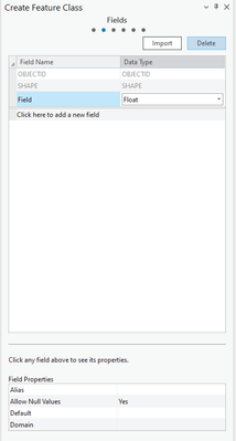

When using the Create Feature Class wizard, including a float or double field does not provide the user with the opportunity to specify precision or scale. This would be useful because while disallowing this capability helps to circumvent  other issues with these fields (such as the specified field type being ignored if the precision and scale are incompatible), it also makes it easy to overlook improper scale and precision settings if a user enters data into the feature class before they manually alter the defaults.
As it stands, default values for precision and scale are 6/1 for Float and 7/1 for double. If a user wants to adjust these values, they need to do it before any data is added to the feature class. It would be nice to specify the values during the creation of the feature class itself.

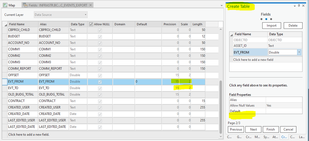

Agreed. I want to create DOUBLE fields in the Create Table wizard where the precision is 15 and the scale is 2.
ArcGIS Pro 3.2.2

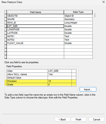

Yeah I came to see if this was an idea already or not. Currently the only way to define numeric precision is through the Alter Field GP Tool or the Data Design GUI. I would argue that most users create feature classes utilizing the Create Feature Class / Create Table wizard. Based on @RonnieRichards comment above, it looks like this functionality was present in ArcGIS Desktop and just was not ported over to ArcGIS Pro.
https://support.esri.com/en-us/knowledge-base/how-to-customize-numeric-data-precision-and-scale-in-a...
The current state of affairs is pretty burdensome as a field as to be newly added, properly defined, and then the old field tossed out. My organization has had to do a lot of re-work in terms of data clean-ups as our Analysts were unaware of the default values that were being created through the use of the Create [...] wizards.
