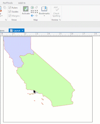

When making a layout I am allowed to "zoom to layer" within a map frame without activating the map frame. However if I want to change the extent to that of a Bookmark, then I have to activate the map frame.  The need to activate to use Bookmarks seems unnecessary and significantly slows down workflow.

It is currently possible to use bookmarks for a map frame in a layout without activating the map frame.
 This is also described in https://pro.arcgis.com/en/pro-app/latest/help/layouts/work-with-a-map-on-a-layout.htm
Can you clarify what the idea is asking for?

Thanks @KoryKramer  I didn't even know that was possible. I stand corrected.  Feel free to mark this closed.
