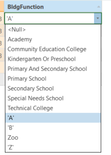

Or are you looking for the domain picklist to be sorted differently?

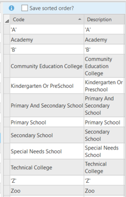

If the latter, you could sort the domain and save the sorted order:
But from your description it sounds like you're not seeing the sorting order you expect when sorting the field itself.  Can you provide screenshots and some examples of the domain values containing single quotes?

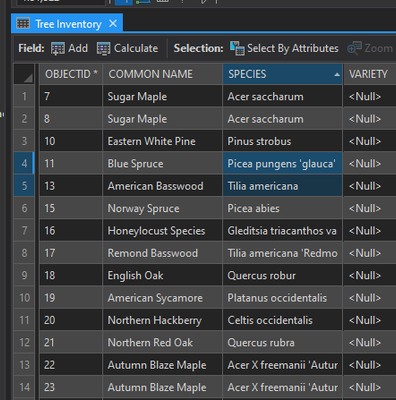

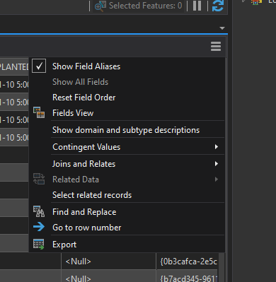

The domain picklist is in the correct order. It is the values in the table that will not sort property. If I uncheck "show domain and subtype descriptions" the values sort properly.
But when it is checked I cannot sort the values in the field, as you can see in the screen shot below. I was told by the support technician this is by design and not a bug.
