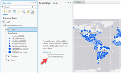

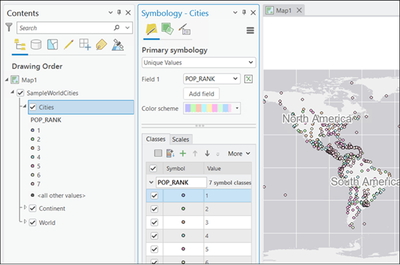

Starting ArcGIS Pro 3.5, you can modify symbology for sub layers inside a map image layer.
  • map services must be running on 10.9.1 server or above and must be published from ArcGIS Pro.
  • limited to feature layers only. Modifying symbology for raster layers is not supported as map services don't allow that.
  • you need to get into dynamic layers mode by clicking on 'Modify symbology' command on the Symbology pane
  • to reset to the symbology defined in the source map service, go to the burger menu on the Symbology pane and click 'Reset symbology to service defaults' command
  • supported renderers: Single Symbol, Unique Values, Graduated Colors, Graduated Symbols and Proportional Symbols
