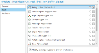

It would be helpful if the default Template Properties for Tools used when creating new features could be modified and saved to a project level. Currently, these properties can only be saved per feature layer. Users have to modify the properties for each new feature layer that is added to a project.

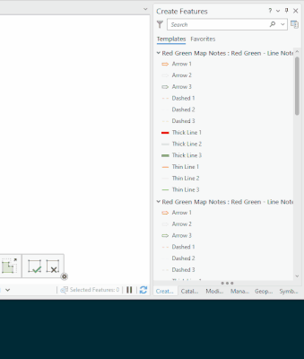

FYI @Mitch_East this might help you...
We have the ability to update multiple templates at once by selecting them (SHIFT or CTRL to select multiple). In the GIF below, I also 'Group By' geometry type so it's easier to find templates from layers of specific geometry types.
