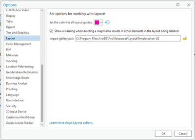

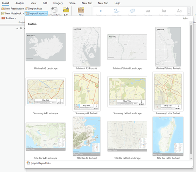

This is actually already available in ArcGIS Pro. The New Layout button lets you add a blank layout, but the Import Layout button actually has a gallery of pagx files. There are 12 that come with ArcGIS Pro and you can actually update the folder that gallery points to in the Application Settings so that it includes a custom collection of pagx files. Companies and other organizations can have all members point that gallery to the same set of files so they have quick access to approved or common templates.
