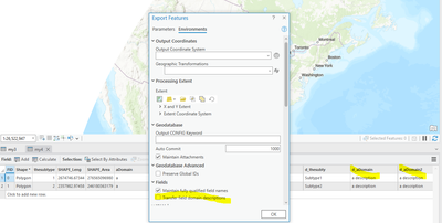

@USERMIPUY @LironNavi This feature is already implemented for both Export Features and Export Table tools when using the environment set to Transfer Domain Descriptions checkbox.

The problem with how this is currently implemented is that it adds additional fields with the domain description. The preferred implementation would be replacing the domain codes with the descriptions in the same field. This might require an option to replace numeric fields with a text field in order to display the description.
JonathanNeal
@DennisSkultety Right, this is only for shape files because they do not have anywhere to put the information like geodatabases do.  For geodatabases the domains will be copied to the new geodatabase so there is no need to add new fields with the domain descriptions.  I suppose that we are trying not to alter your data in case you need to preserve your lookup keys.
