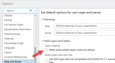

TanuHoque
@Bud
does this option not work in your workflow?

TanuHoque
Please see my previous comment

ValeriaChavez
Hi @Bud! We will be keeping this Idea as "Already Offered" and, instead, moving @SimonShütte_ct's comment to a separate Idea. Thanks!
SimonSchütte_ct
"The Layer Visibility recommended by TanuHoque is a global switch. Some more control is needed"
(My comment Bud was referring to, just for context.)
