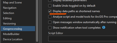

For geoprocessing, have you unchecked 'Display data paths as shortened names'?

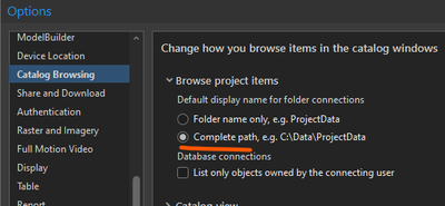

Under Catalog Browsing there is also 'Complete path':
I realize the idea is for geoprocessing etc dialog boxes but I'm wondering if these help?

@KoryKramer Yes. Missed the option in Geoprocessing settings.

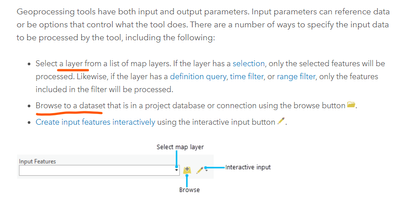

As I'm sure you know, layers and data sources are fundamentally different. Layers store things like symbology, definition queries, selections, filters like time and range, and so on. That is very different than just pointing to a data source. https://pro.arcgis.com/en/pro-app/latest/help/analysis/geoprocessing/basics/run-geoprocessing-tools....
So dragging a layer into a tool as the tool's input should not switch to only reference the data source, nor indicate that the direct data source is the tool's input.
