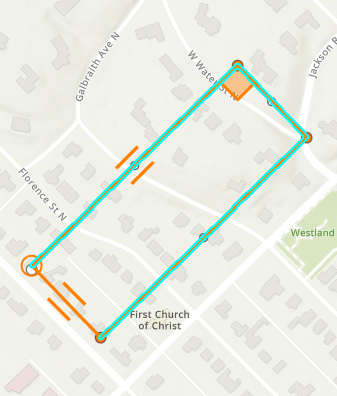

It would be very helpful for ArcGIS Pro to have a Geometry Guides setting similar to what the ArcGIS Online Map Viewer already does. I know ArcGIS Pro already has a right angle line tool when creating new lines or polygons, but that is not available when editing vertices. A global/universal Geometry Guide setting in ArcGIS Pro would:
  • allow users to create uniform lines and polygons whether they are adding a new feature or updating an existing feature
  • allow features to be created faster because you would not have to switch back and forth between the line and right angle line tools
I do not want this to replace the any tools but instead compliment the editing tools that are already available.
Here is an example from Map Viewer of what I am talking about. I created a line feature, and the geometry guides let me know that I have a right angle, the third line is parallel to the other side, and the end is now perpendicular to the starting point.

@ZachBodenner thank you for the information and I had not until now. The inference constraints is partially what I am looking for. However, I would like to have the visual cues that the Map Viewer has with the geometry guides, and the inference constraints did not work for me when editing vertices of existing features.
