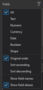

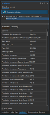

In some instances I would prefer to have field names rather than aliases appear in the attributes pane, and I could also see sorting and filtering being useful. There is a menu available elsewhere in the application that would be very nice to have...
...somewhere in this pane:
Field name & type etc. is available on hover, but that's a nuisance to have to do when you want something at a glance.

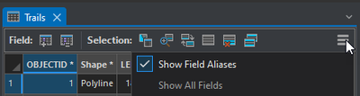

Regarding displaying field names versus field aliases, this is possibly via the layer's Attribute table.  Uncheck 'Show Field Aliases' to display field names.  This setting applies to the table and the pane.
Thank you for the feedback regarding sorting and filtering as well.  We are tracking it as an enhancement request.

@Jennifer_Cadkin  wonderful! I hadn't noticed that the table toggle controlled the attribute pane but I just gave it a try and it worked. I don't always have the table open when using the pane, so yes, that filter/sort/alias toggle would still be a good addition IMO. Thanks for looking into it.
