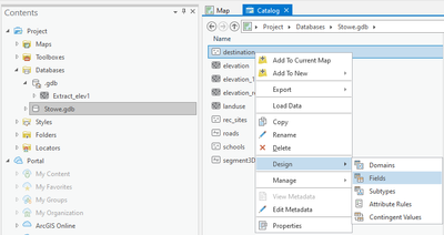

From this comment "We wouldn't have to add table in a map to configure field or domain on a feature class when we are in catalog view."  I just wanted to make sure that you were aware of the context menu Design > Domains and Design > Fields options.
It is possible to open those design views without the need to add a table/feature class to a map.

Yes it's this menu, I don't know this option.

Thank you, Gaetan, for confirming that accessing the Fields View and Domains View from the context menu meets the need.  We’ll mark this as Already Offered by using the context menu workflow.
