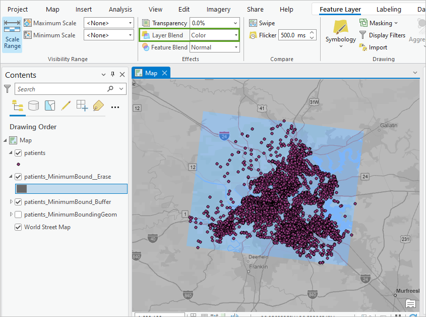

BobBooth1
You can do this with blend modes.
Make a feature around your AOI, buffer it, change the color to dark grey, and then use blend modes>color to grey out the area outside of your AOI.
https://www.youtube.com/watch?v=AHAvL_hrWTo

BxJMO
@BobBooth1 The issue is that creating a feature in its own feature class, with its own symbology and other properties feels like a workaround rather than a solution. The idea is to be able highlight the area of interest of features in a feature class layer by applying various properties with the inverse effect of masking to that specific feature class as opposed to creating a new feature within a new feature class and editing those properties. In a perfect world, I'm able to apply a mask to a layer and just check a box that says "Invert Mask"

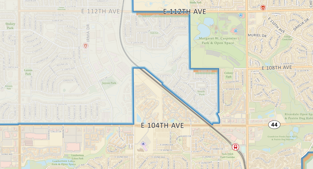

DanMakridakis
@BobBooth1Blending modes are great for complex cartography, but they don't quite fit the issue discussed in this post. Your suggestion is more of an example of creating a feature to fade out the area outside an AOI, which is possible using the masking tool; while, I need to do the opposite—clip areas inside the AOI. Currently, clipping options are too restrictive; we need layer-level control similar to masking, with the ability to combine multiple layers.
Your solution also doesn't tackle the challenge of differentiating labels within an area from those outside. For example, in my attached basemap, I had to categorize streets, highways, and parks differently by splitting these features and assigning "inside" and "outside" the city values. This gets even more complex with maps that represent our utility service area or future growth areas which extend beyond our city limits, each requiring unique label queries based on the boundary type.
I could create an inverted polygon for each boundary and apply clipping in the Map Properties under "Clip Layers," but this only works with one boundary for the whole map. If the boundaries change, as they do in our growing city, I'd have to update every feature I've split or recreate my inverted polygons.
If we had a clipping menu that functioned like an inverted masking menu, our maps would automatically update with boundary changes and there would be no need to maintain clipping features or manipulate my master data for the sake of cartography.
(I've also updated my original post to provide more detail)
