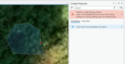

If a sketch fails, during reshape or create for for example, the sketch persists and can be continued.  Here is an example of what it would look like- failure notification in the pane and sketch persisting on map.  Can resume sketch by clicking in map- e.g. add or modify vertices and segments (plus address the reason for the failure as appropriate), or discard the sketch.
