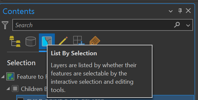

That said, we did find a keyboard shortcut + click method to enable ALL layers as selectable again, but this shortcut was not at all obvious.
To make ALL layers selectable again (top level and sub-level layers), navigate to the "List By Selection" view in the Contents pane. Hold CTRL + SHIFT on your keyboard, then click any layer (nested or not). This will make ALL layers in the map selectable again.

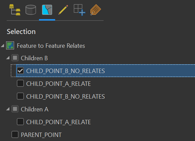

Note that the reverse is also true. If all layers are selectable and you use the shortcut above, it will turn off selection for all layers.
E.g. Only one layer is selectable

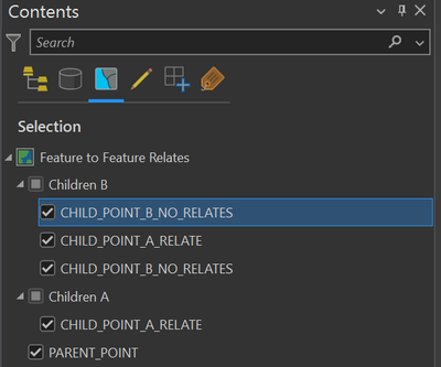

Using the CTRL + SHIFT + CLICK to enable selection for any layer currently not selectable will change ALL layers (grouped or not) to selectable.
