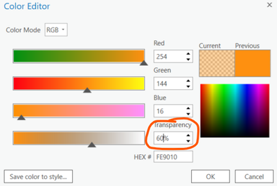

Hi @ChristopherBowering This can be controlled for the fill through the symbol's color properties.

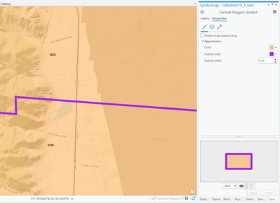

Before:

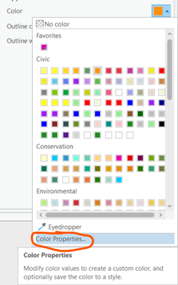

Go to color properties:

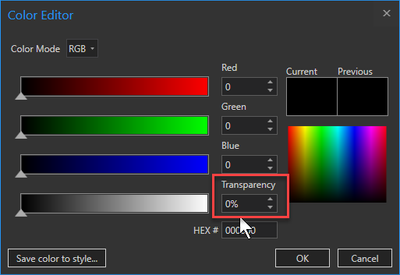

Set the desired transparency:

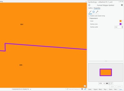

After:
The outline transparency can be controlled in the same fashion.
Hope this helps!

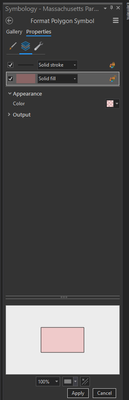

On the symbology pane, select Properties then the Layers button which will allow you to symbolize the outline and fill separately.

You can currently do what you described. To do so, leave the transparency set to 0% via the Feature Layer>Appearance tab. Then, you can set different transparency levels to the fill/outline symbol.

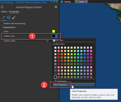

1) Bring up the symbol properties for the symbol you want to apply transparency to. Then click the color swatch and choose Color Properties...
2) Set the Transparency level to whatever you need.
3) Then go back and click the Outline Color, Color Properties...
4) You can then set the transparency of the outline symbol to whatever you want. In the case you described above, you would just leave the transparency set to 0%.
So, if you need to set different transparencies for the fill versus the outline, the key thing to remember is to leave the transparency of the layer at 0%, and then alter the transparency of the symbol itself (fill versus outline).
