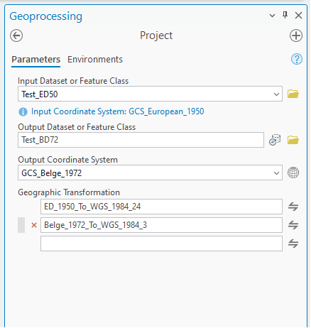

The Project tool in ArcGIS Pro allows users to manually define custom transformation paths. The tool only verifies that the transformation sequence correctly passes through all required geographic coordinate systems but does not enforce area-of-use constraints. For instance, in the example provided bellow—transforming Austrian data from ED50 to WGS84 (via a Norwegian transformation), and then to Belge 72 (via a Belgian transformation)—the Project tool successfully applies the specified transformations.
Please note that this approach only works with mathematical transformation methods, such as position vector or coordinate frame (7-parameter) transformations. Transformations that rely on grid-based methods, like NTv2, will not transform coordinates outside the used transformation grids.
