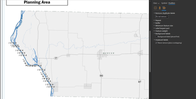

wayfaringrob
@KoryKramer  I'm having some issues with that. With boundary placement labeling, an extra label for the feature clipped out is appearing.

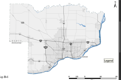

Ex - at first, I got this:

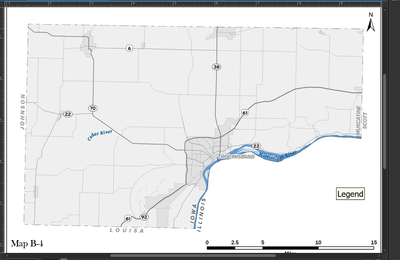

Then, when I set it to 'remove all,' the pair is placing just fine (allow single-sided turned OFF), but I get a bonus label for Iowa.

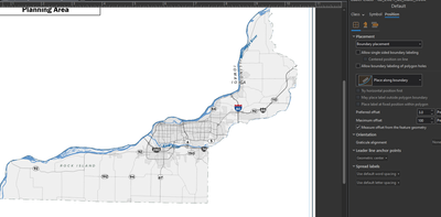

Map series turned off, we're back to normal, even with 'do not remove' duplicates:
At first I thought it could be related to a mismatch in geometry between my county (index/clipping) layer and my state layer, but they're perfectly coincident down to the gnat's eyelash.

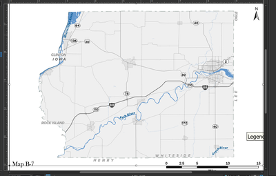

It happens for every county that borders another state:
One shows only a label for the other state:
Am I missing something in the settings that would get this straightened out? I'm not sure how I would approach using annotation or graphics in a map series.

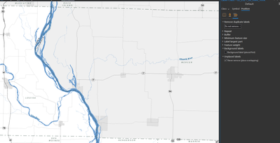

More unexpected results when more than one boundary is labeled. In this case, only one label for the index feature is placed despite 'allow single sided labeling' turned off, 'do not remove' turned on...
Expected (map series disabled):

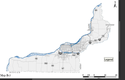

More issues:
Seems like this isn't really implemented? @SamuelTroth2
