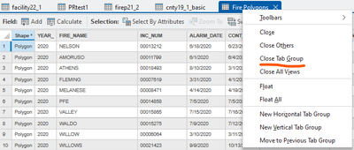

In ArcMap, you could have several attribute tables open at once and choose to close them individually, or, you could use the "X" to close the attribute table view entirely - which was great when you had multiple tables open and didn't want to close them one at a time. In Pro, this capability was removed, and we have to click the "X" on each individual feature layer attribute table tab to close the table. And when you have several attribute tables open at once, you also lose visibility of the first table tabs opened once there are more than what the width of your screen allows; you're forced to close some until you get all table tabs within the docked table view again. I work with utilities, so it's pretty common I have all the attribute tables open for an entire commodity, which can be 20 tables, and I even have an extended monitor.
1) Can Pro bring back that functionality from ArcMap for ease of closing the entire attribute table view in one swift click, rather than two to forty clicks, by bringing back an X in the attribute table view?
2) Ability to scroll to see multiple attribute table feature layer tabs, rather than having them cut off (see screenshot, far left "Power" is cutting off the feature layer Water Standby Power, and there are 3 more tabs in front of it no longer visible)

Hi @sjvorona.,
The ability already exists, what you can do is dock all of your attribute tables in a single window on a separate window. When you close the main window, all of the tables will close also.
KoryKramer
There are different ways to manage multiple attribute table views. Thank you for including a screenshot of your setup. To close all of those at once, right-click a tab > Close Tab Group.
CatherineHall678
Well I'll be darn. Thank you @KoryKramer !!!
