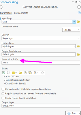

When converting labels to annotations in Pro you cannot change the name of the annotation feature class (AFC) nor can you add a prefix to the default name.
Please add the ability to create a custom feature class name as well as the ability to set a prefix to the default name.
We prefix all our AFCs with 'anno_'  so that they are grouped together in the GDB.
If there are many AFCs created from the same layer name (same layer added multiple times) then you have to use a custom suffix for each one and then go back to the GDB and rename them to something sensible.
A workflow now has to be discarded because Pro cannot do what ArcMap does.

@KoryKramer  Please tell me what the rationale and process you had in mind was for the following:
  • Not allowing us to rename annotation layers in the "Convert Labels to Annotation"
  • Placing resulting annotations in a group layer
These are steps I now have to go through every single time to get the required data names / map structure (rename in gdb and remove from group).
It is a non-trivial change from ArcMap so I assume there has to be some clear reason why; and if you can tell me it may help me do things better.
My process:  Prefix all annotation with 'anno_' so that they are all together at the top of a gdb in catalog view. Then they may also be named to set the doc version, reason, style used, etc. We may have the same dataset labelled/anno'd multiple times for different documents or document versions.
I may place all final annotations in a group layer (e.g. to turn them off easily to see what labels remain) but usually they are each just a single map layer on their own.

We use a process that has all annotation layer names start with an 'anno_' prefix.
This was easy to add/do in ArcMap but Pro only allows suffixes, so now we have to convert labels to an annotation feature class then rename them. Every Time.
Please add the option to define a prefix or suffix, and while you're in there, add a checkbox to choose if Pro should create an output layer or not.
I never use the Output Layer as I may have other groups etc already set up so this adds yet another inefficiency for me.
