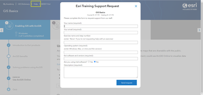

I'm a student working with the GIS Basics tutorial on Pro 2.8. I'm in Part 4 where I try using ArcGIS online. It wants me to open ParkLocations.csv as a layer in Map Viewer Classic, but whenever I try it says that no locations could be found. What the heck is up with this? I'm adding the file they told me to download and add, but it just isn't working. I'm doing everything by the letter.
-Kiernan @ Western Washington University
TimOrmsby
Hi Kiernan,
Best way for you to get help on this: at the top of the web page in your course, click the help link and fill out the Esri Training Support Request form.

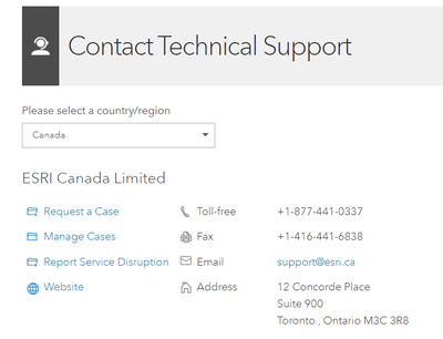

Only users in United States can log bugs apparently.  I've found a repeatable critical bug in 3.0.2 that causes ArcGIS Pro to crash in the Python window but I have to fill out a bunch of forms for a "Support Request" because I'm in Canada and that's a real pain.

I looked in our support system and it appears that you should be able to open a case with Esri Canada Technical Support. Have you tried calling?

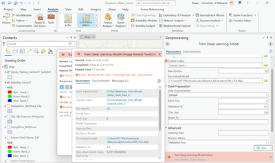

Error:division by zero.Training was not successful. (ArcGIS Pro Training Deep Learning)
I have a small area, so I change image chip 128 instead of 512 to extract training sample, it works.
If I use 512, then I get only three samples so I decrease it to 128
Also, I faced other error: Error:Error(s) in loading state_dict for _DeepLabOverride: size mismatch for backbone.conv1.weight: copying a param with shape torch.Size([64, 3, 7, 7]) from checkpoint, the shape in current model is torch.Size([64, 4, 7, 7])..Training was not sucessful
then use extract band make three bands, it solved
I have 7 samples and I use 0.5 in the % validation parameter, to make whole number. Still I got the Error:division by zero.Training was not successful.
