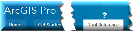

Tool Reference
Main link and one of the most important...
ArcGIS Pro tool reference—ArcGIS Pro | ArcGIS for Desktop

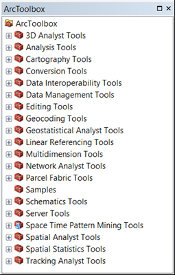

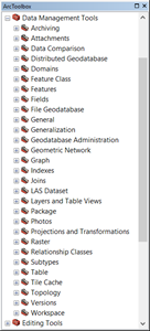

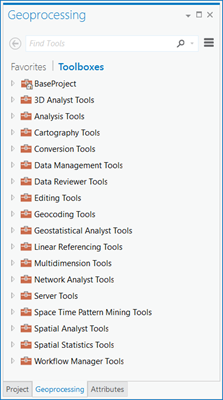

Basic toolbox layoutArcGIS 10.3.1ArcGIS Pro 1.1.2
The toolbox comparison is shown to the right.
Tools that are absent are not implemented in Pro currently.
Some functionality from ArcCatalog, has been moved to Arctoolbox so don't be afraid to explore the toolbox.
Toolbox comparisons...

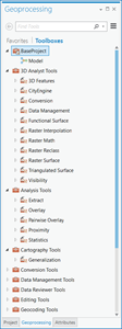

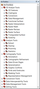

3D, Analysis, Cartography
ArcMap                                              Pro

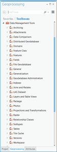

Data Management tools
ArcMap                                              Pro

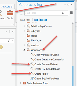

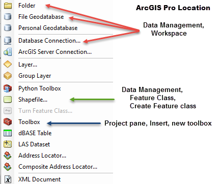

ArcGIS Pro's ArcCatalog equivalentsArcCatalog versus Pro location
These are a few of the changes in Pro that reflect old ArcCatalog functions that are now located in ArcGIS Pro.
For example, things like making folders, file geodatabase etc are now located in the Data Management, Workspace toolset.
Similarly, creating shapefiles is now located a new spot.
