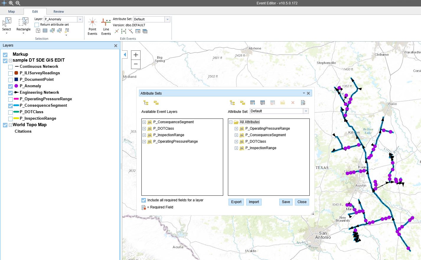

Hi,
I fiddled around with the following in the EventEditor config.json file (changed from false to true, C:\inetpub\wwwroot\EventEditor) and they appeared (see screenshot)
"attributeSetEditing": {
"showEventIDField": false,
"showLayerNames": false
APR EventEditor edit JSON file for Attribute Sets to display layers

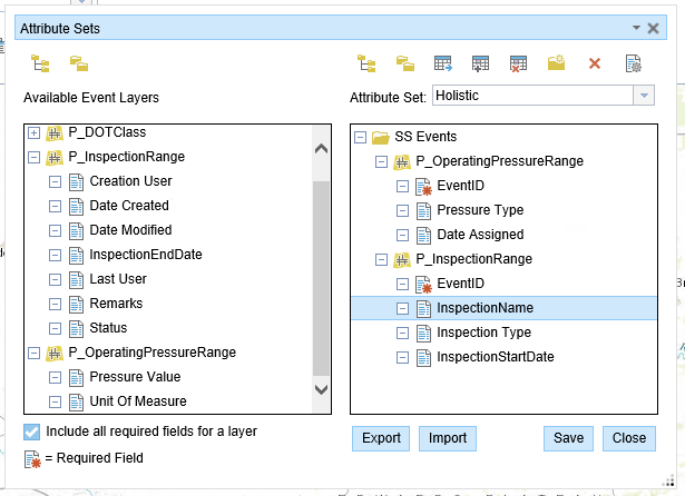

However, the relief was short lived:
Any ideas / information welcome.
Thank you,
Danny.
by Anonymous User
Not applicable
This relates to the fact that the tutorial documentation displays the Attribute Set configuration as:
However, it should be configured like this:
Onwards.
