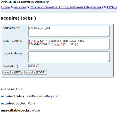

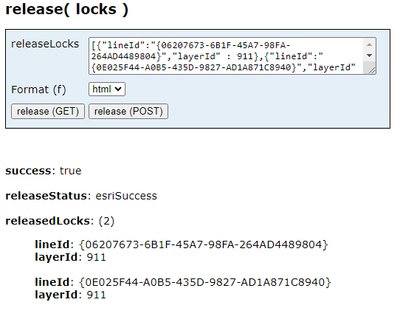

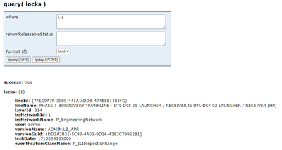

Here are some samples from my sandbox environment intended to demonstrate the REST API calls. User specific LRS model, LRS attributes need to be factored in and modify parameters to make it work.
  • Query locks: Home > services > Pipeline (MapServer) > LRServer > locks > query  - where 1=1  The response gives you the format sample
  • Acquire locks: Home > services > Pipeline (MapServer) > LRServer > locks > acquire  - ADMIN.Ayan_APR | [{"lineId":"{06207673-6B1F-45A7-98FA-264AD4489804}","layerId" : 911},{"lineId":"{0E025F44-A0B5-435D-9827-AD1A871C8940}","layerId" : 911}]
First attempt executed but no locks acquire as reconcile was needed.
Reconciled versions and acquired locks
  • Release locks: Home > services > Pipeline (MapServer) > LRServer > locks > release  - [{"lineId":"{06207673-6B1F-45A7-98FA-264AD4489804}","layerId" : 911},{"lineId":"{0E025F44-A0B5-435D-9827-AD1A871C8940}","layerId" : 911}]

AyanPalit
