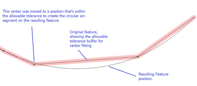

@DeanAnderson2   I can give possible reasons for two of the items you mention, the one about circular arcs getting created when you don't what them to be, and the other about resulting feature geometry being outside the specified offset. Without seeing examples it's hard to know if these make sense for your cases.
It is possible that the Simplify By Straight Lines and Circular Arcs GP tool can result in a circular arc that bows out beyond the Maximum Allowable offset from the initial feature’s geometry. This may occur if you chose the Fit to Vertices option, and it is also more likely to occur with a larger value for the Arc Angle Step.
The algorithm works by taking the positions of the vertices and trying to fit straight lines and circular arcs and by allowing the positions of any of the original feature vertices (except the first and last vertex of the feature) to be iteratively varied within the Maximum Allowable offset until a best-fit circular arc and/or straight line can be found.
This can result in a new circular arc that bows outside of the offset distance while not breaking the conditions of the algorithm because the original vertices that are used to define the circular arc are still within the allowable offset. Here's a graphic showing this:
To avoid the likelihood of this happening, you can either:
  • Use the Fit to segments option instead, because this option uses the segment geometry, OR
  • Reduce the value for the Arc Angle Step if you are using the Fit to vertices option.
